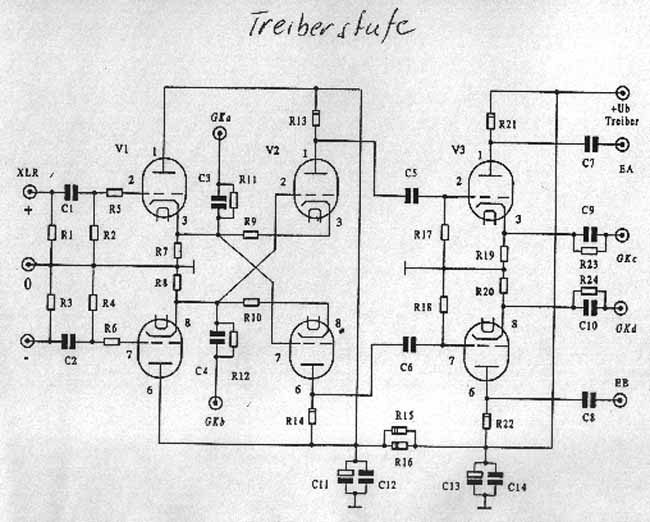

Widerstände |
R1,R2,R3,R4 |
100 |
kOhm |
R5,R6,R7,R8 |
1 |
kOhm |
R9,R10 |
560 |
Ohm |
R11,R12 |
15 |
kOhm |
R13,14,21,22 |
47 |
kOhm |
1Watt |
R15,16 |
39 |
kOhm |
2Watt |
R17,18 |
1 |
Mohm |
R19,20 |
1,5 |
kOhm |
R23,24 |
820 |
kOhm |
Kondensatoren |
C1,2 |
1yF |
100 V |
MKP |
C3,4 |
270 pF |
63V |
MKP |
C5,6,7,8 |
0,22 yF |
630V |
MKP |
C9,10 |
10 pF |
500V |
Keramik |
C11 |
22yF |
450V |
ELKO |
C12,14 |
0.1yF |
630V |
MKT |
C13 |
10yF |
450V |
ELKO |
Röhren |
V1,3 |
ECC 82 |
V2 |
ECC 83 |

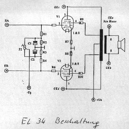

EL34 Beschaltung |
Röhren |
EL34 |
R1,4 |
220 |
kOhm |
R2,3 |
100 |
kOhm |
P2 Trimmpoti |
100 |
kOhm |
R7,8 |
10 |
Ohm |
5Watt |
R5,6 |
1 |
kOhm |
R9,10 |
1 |
kOhm |
2Watt |
Übertrager |
Raa 3,4 |
kOhm |

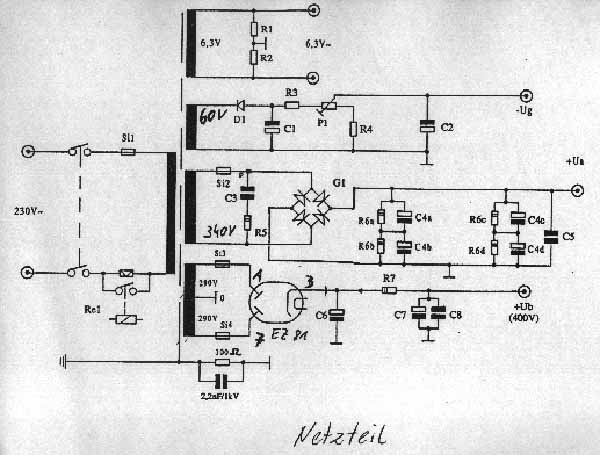

Einschaltstrombegrenzung |
R1 |
100 |
Ohm |
R2 |
5x 120 |
Ohm |
parallel |
C1,2,3 |
1000 yF |
63V |
Relais |
12 |
V |
250V/10A |
