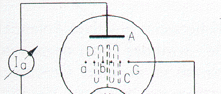

Heinrich Barkhausen: First Transit Time Microwave Tube
The retarding-field tube (or reflex triode) can be regarded as the first transmitter
tube. It was invented by H. Barkhausen (*1881-†1956) (Fig. 17) in 1920.
During some measurements on a triode with a positive grid and a negative anode
(Fig. 18) Barkhausen and K. Kurz noticed irregularly fluctuating anode currents.
Barkhausen interpreted them as self-excited oscillations generated by the tube
[8,9]. Later they were known as "electron dance oscillations" on account of the
oscillatory motion of the electrons around the wires of the grid. Due to the
existence of a retarding field between the grid and the anode the name 'retardingfield
tube' was generally adopted. It is interesting to note that the three effects
characteristic of transit-time devices are already present in the retarding field tube:
they are velocity modulation, bunching (i.e. conversion of velocity into
Fig. 17: Heinrich Barkhausen Fig. 18: Retarding-field tube and its circuit.
density modulation) and power transfer from the beam to the circuit. The principle
can also be described by extraction of "wrong phase" electrons and negative
absorption by a stationary ensemble of non-isochronous oscillators [10].
