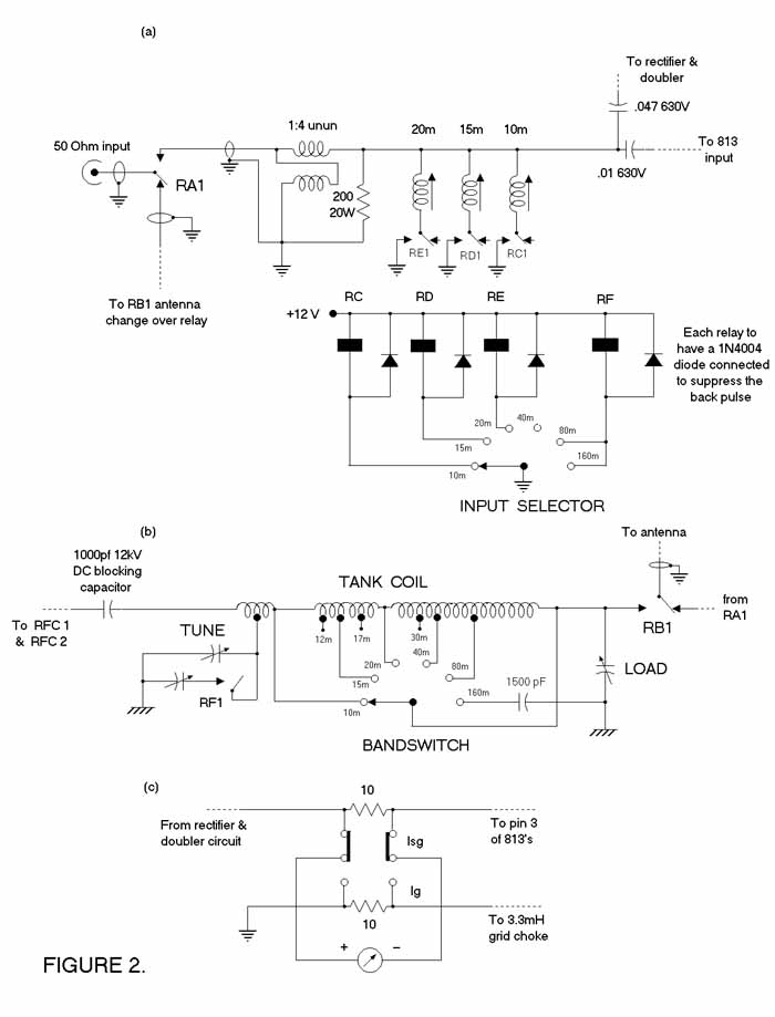

Turning to the circuit in Figure 1, drive is applied through contacts RA1 of input relay RA. I have separate input and output switching relays. Relay RB has the antenna change-over function. These two relays pull in together when a relay in your rig closes after the press to talk button is pressed. You must ensure that this relay has a set of contacts which places an earth on the "ground side" of RA. If you are unsure, read your manual. The 1:4 unbalanced to unbalanced [ unun ] transmission line transformer transforms the 50W impedance to 200W to match the 200W grid resistor, which should be rated at 20W. I used a commercial 200W 50W non-inductive resistor. Surprisingly, 5 x 1kW 5W resistors in parallel gave quite satisfactory results, particularly as they have some inductance.
Drive is sampled and fed through a 0.047m F 630V capacitor to the rectifier-doubler which comprises 12 BAW62 diodes, each shunted by a 220kW 0.5W resistor. A DC voltage proportional to the driving signal is applied to the screen grid of each 813. This method of generating the screen voltage works extremely well. The tubes draw around 40 - 50mA of plate current with no drive, as the screen voltage is zero. With drive, the screen voltage rises quickly to 200V or so. Do make provision to meter the screen current as it is a better indicator of resonance in the tank circuit of tetrode and pentode tubes than the conventional method of dipping the plate current.
A 0.01m F 630V capacitor passes drive to the control grid of the paralleled tubes which are operated in zero bias class AB2 configuration. When driven positive, grid current flows through a 3.3mH RFC [ Altronics L 7052 ] and must be metered with a 100mA FSD meter as it indicates the level of drive from your rig. While separate meters are shown to read Isg and Ig, you may use one meter. A DPDT switch is used in my amplifier. 10W 0.5W resistors bridge the position nominally occupied by the meter to complete the circuit when the meter is switched to the other position. See Figure 2 (c) for a circuit of this arrangement.
You will notice that on the circuit diagram in Figure 1, I have a different symbol for earth at the grounded end of the plate and load capacitors. All connections made to this point, like the beam forming plates and the filament and screen bypass capacitors should be connected by 1 cm wide copper strap or brass shim. Because the tubes are not neutralised, it is imperative that a low impedance common ground be available to prevent instability. No trace of errant behaviour has been detected in the two amplifiers made to this design.
The 1mH RFC across the output is a mandatory safety item. Should the 1000pF DC blocking capacitor ever break down, you will have the high tension supply connected to the antenna system. The choke will shunt the DC to earth and open the 10A fuses in the primary side of the plate transformers. Under no circumstances is this choke to be left out. It comprises at least 100 turns of 0.4mm enamelled wire on a 50mm length of ferrite rod. Apply a layer of insulation tape before and after the winding is done. It does not matter if 2 or 3 layers of wire are used. Antenna change-over relay RB is an Altronics S 4197 job.

The plate tank circuit is a modified pi-network. The plate tuning capacitor is tapped to the centre of the 10m coil to allow a more optimum value of Q to be obtained from 20m through to 10m. The 10/15/20m coils should be wound with 3.6mm copper capillary tubing that is used in pressure gauges, but 1.5mm wire can be safely used below 20m. Hobby shops often stock suitable capillary tubing. Try to orientate the 10m coil at right angles to the 15/20m coil to minimise coupling and losses.

For the 160m to 40m coil which is wound in one continuous winding, the turns should fit tightly against each other. A tapping point can be made by twisting a small loop in the wire, then continue with the winding to the next tapping point. I used 60mm pvc pipe for the coil former.

Input Circuit
Now that the plate tank circuit has been taken care of, we need to ensure the input side can accept all bands from 160m to 10m. The unun consists of 13 bifilar turns of ordinary hook up wire on an 80mm section of standard ferrite rod. This works as well as any toroid I have experimented with.
Due to the input capacitance of the tubes, the SWR increases to around 1.5 : 1 at 20m. To maintain a low SWR from 20m to 10m, use slug tuned coils to form a parallel resonant circuit with this capacitance. They are switched in by miniature relays [ Altronics S 4160 ]. For 20m use 20 turns of 0.4mm wire on a 6mm former. The 15m coil consists of 12 turns of 1mm wire on a 6mm former, and the 10m coil consists of 6 turns of 1mm wire stretched to a length of 1cm on a 6mm former. All coils are fitted with an F14 slug.
Once the coils have been fitted, the SWR stays very low and flat across each band because of the low Q due to the swamping effect of the 200W resistor. The earth end of R1 should be terminated very close to the braid of the coax bringing the input signal from the contacts of RA1. I have tried to make this obvious on the schematic of the input circuit..
I coupled a 12 position rotary switch wafer to the shaft of the band switch using a switch mechanism from Farnell Electronics. All relays were wired up so that they were switched in according to the band selected. This is a neater option than having to provide a separate ‘input selector’ for switching in these relays. The Farnell stock numbers for the switch mechanism and 12 position wafer are 146-033 and 146-034 respectively.

Metering of the high voltage is best done by sampling the voltage across the bottom bleeder resistor. An appropriate multiplier resistor connects to the meter which is scaled to read 3kV or so. You then do not have the full supply voltage connected to a series of multiplier resistors, giving rise to unnecessary component failure risks.
The plate current is metered by inserting a 10W 10W resistor between the "earthy" end of the plate transformer secondaries and earth. This requires you to lift the framed ends and tie them together. While screen current is also included in the meter reading, it is not significant compared to the plate current. Incidentally, I made up scales for all meters by cutting out letters and digits that were printed out by an ink jet printer. They were then pasted on to a sheet of paper at appropriate positions to form a meter scale. The scale was then photocopied, cut to correct size, and finally pasted on to the face plate of a meter. It was a far neater option than attempting a freehand sketch.
